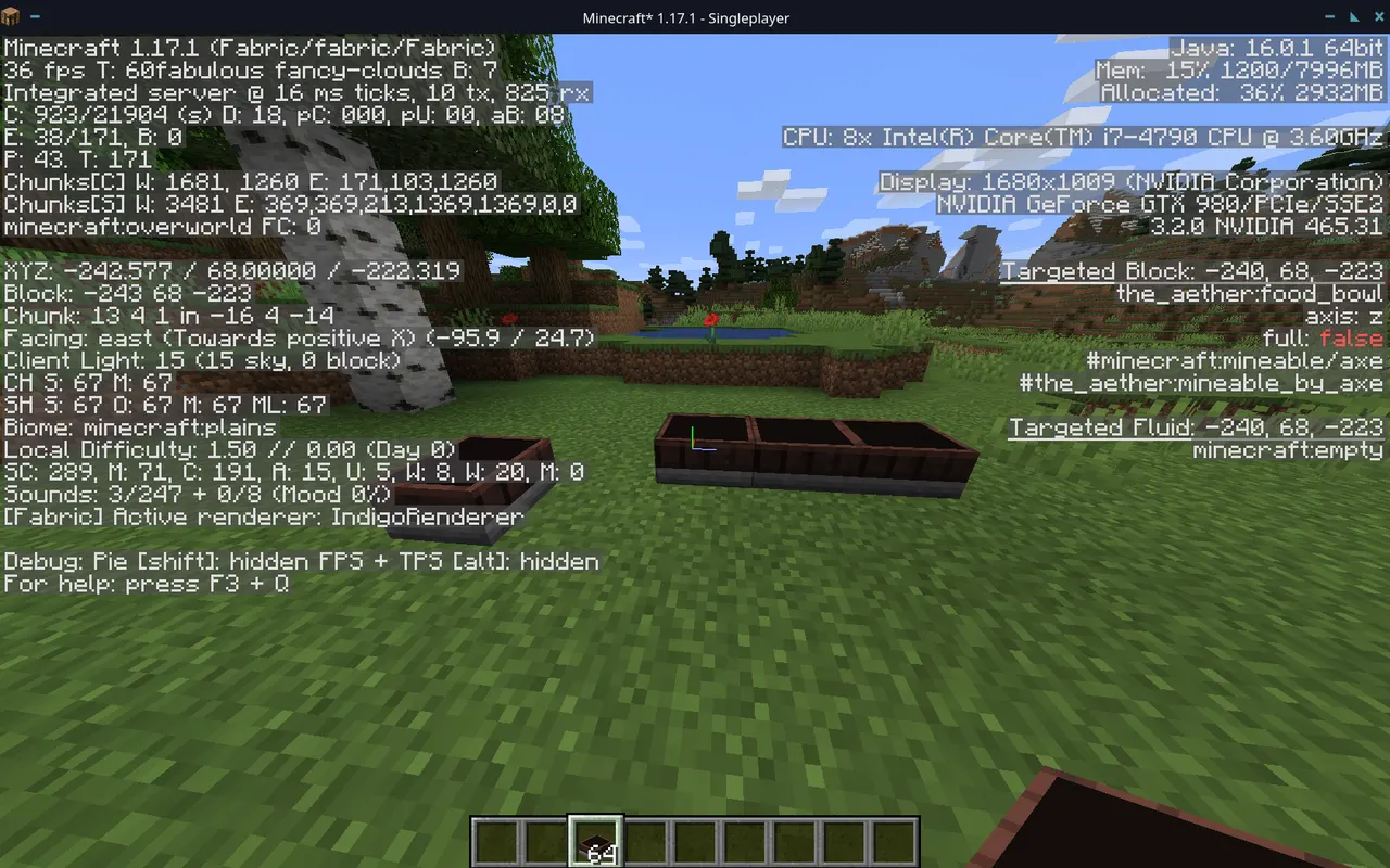

  46. Jack PapelTeam
    Minecraft__1.17.1_-_Singleplayer_2021-07-16_22-14-49.mp4Video, 2.4 MB. Not stored in the archive.
  47. Jack PapelTeam
    Decided to just make them a static color. Makes more sense anyway

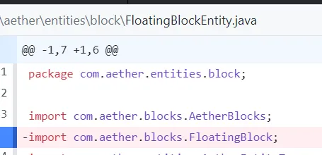

  56. CDAGamingTeam
    Also I fixed up https://github.com/devs-immortal/The-Aether/issues/394 The cause was very ez xD
  57. AzzyypaarasTeam
    wait shit what exactly did you change for that
  58. CDAGamingTeam
    Do you really wanna know
  59. AzzyypaarasTeam
    Yes because if it is anything in MoaEntity I am going to roll in my grave for a different reason
  60. CDAGamingTeam
    Image shared by CDAGaming
  61. AzzyypaarasTeam
    I
  62. CDAGamingTeam
    Yea Azzy I hope you werent doing any moa stuff atm
  63. CDAGamingTeam
    I'm migrating a bunch of this spagetti code over to use a newer format (As the inconsistency found is appaling on it)
