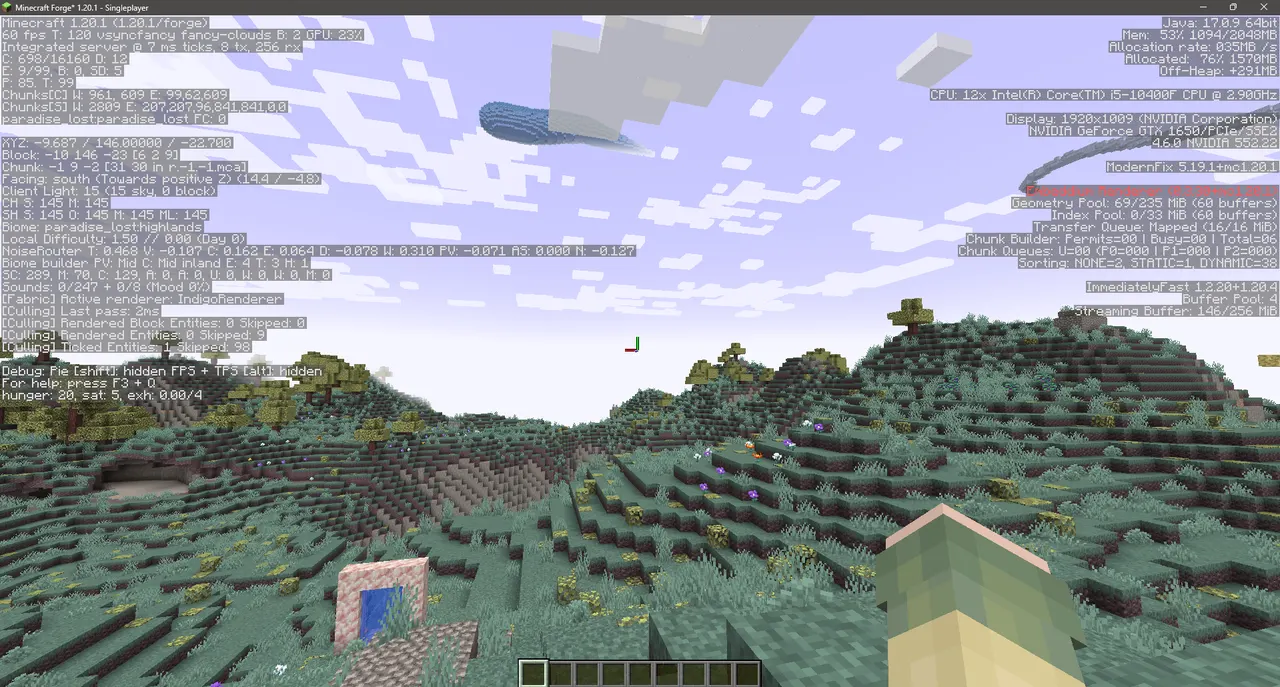

- C01:07(top left)
- K
- C
- C
- K
- COkay I got it, never done this with mixins before so let me know if anything's wrong or feel free to make a change to it yourself01:58made a separate optional mixins.json which throws a fit when loaded with sinytra but it does load and the PL portal works 100%01:58no issues on normal fabric02:03Okie dokie all good on my end, at your leisure https://github.com/kyrptonaught/customportalapi/pull/107

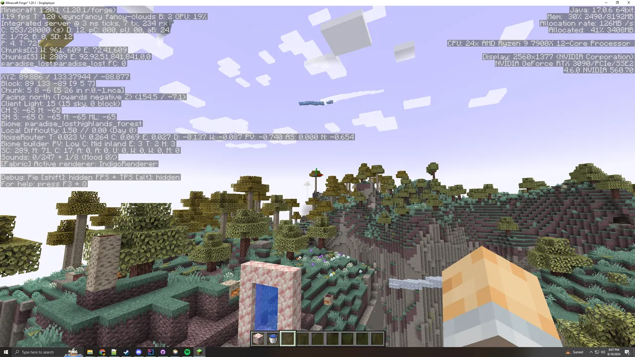

- C13:43@seb "vey" f. when you have a chance, please try loading the b2.2.2 version of PL I just released and it should now be working on Sinytra
- S
Replying tocr24@seb "vey" f. when you have a chance, please try loading the b2.2.2 version of PL I just…
heyyy! it works!!!15:14weird tho, the sound for exiting the portal is just the normal nether one - Cyeah I think that is just sinytra weirdness, it works on normal fabric but I think thatll just be an artifact of using sinytra which is in beta15:17But glad to see it works at least 95%!
