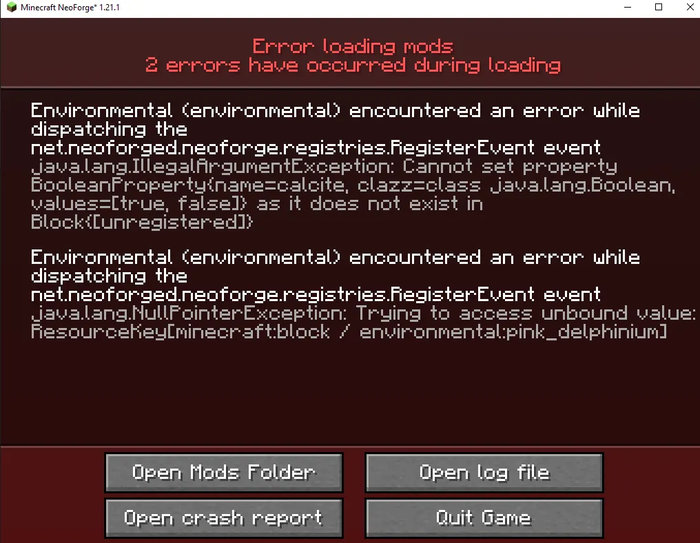

    Hi, im experiencing a crash with paradise lost and Environmental by TeamAbnormals and all the dependencies for both mods. I tried running with just Blueprint (the environmental library mod) and i did not experience any crash so im guessing it's worldgen related possibly. I have disabled all other mods btw. Thank you. Awesome mod.(edited)
    Image shared by Rainy Jim
    this is actually a bug in environmental and not Paradise Lost for once lol. They need to add a super.createBlockStateDefinition(builder) to their PottedCartwheelBlock to support the calcite flower pots that Paradise Lost adds which adds a property to flower pot blocks that is being missed because they are overriding createBlockStateDefinition without calling the base

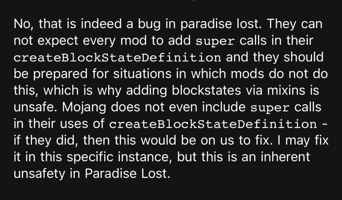

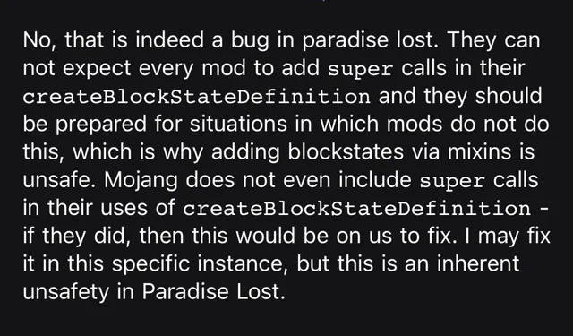

  5. Rainy Jim
    It’s been a little while but the environmental devs closed my report as “not planned” lol
