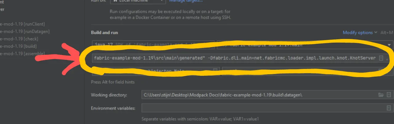

    @Jack Papel Where Do I put it? Im sorry for being a bother
    Image shared by Deleted User
    Program args? You can put it in this box

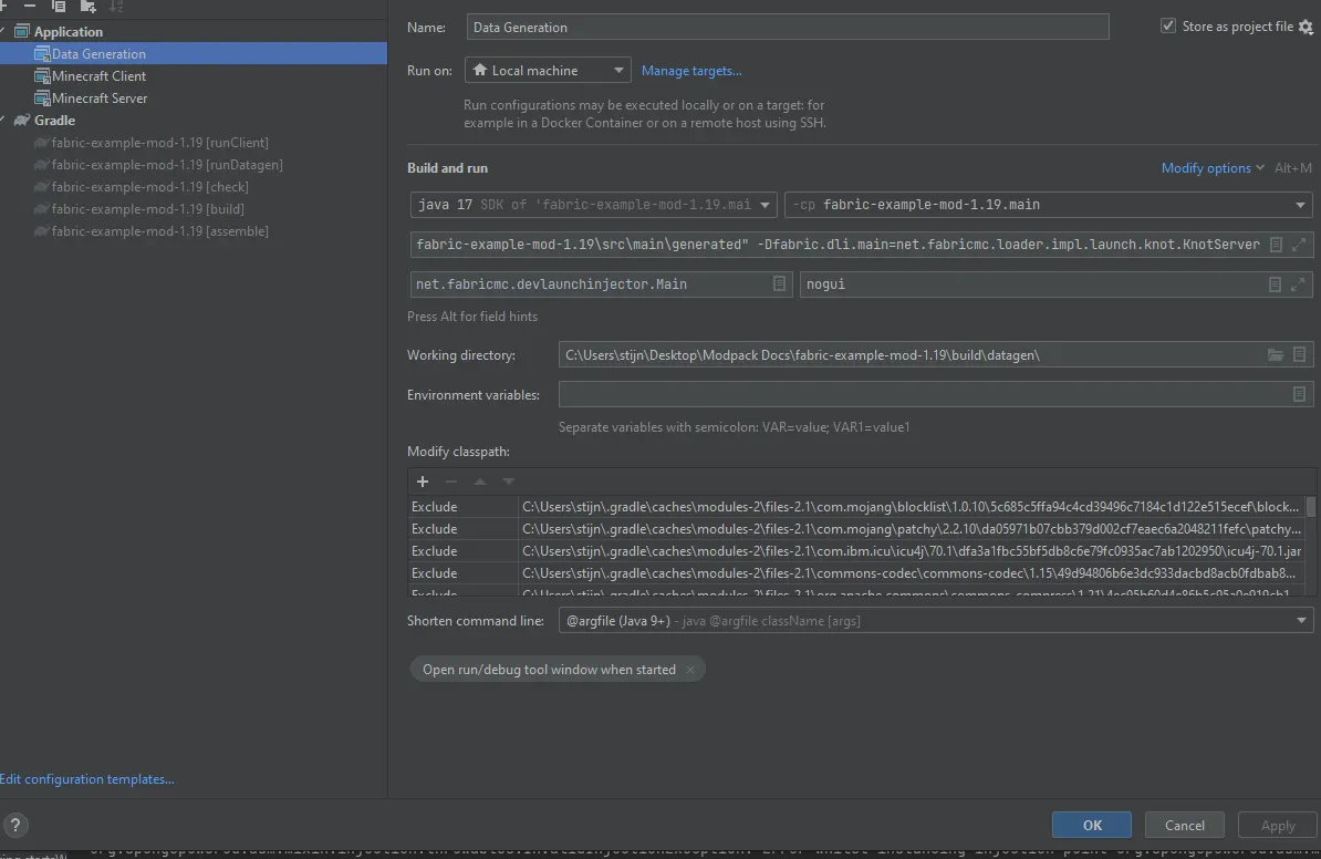

    Hmm, it didnt seem to do the trick
    Can you select all the text in that box and send it here?
  17. Deleted User
    Replying toJack PapelCan you select all the text in that box and send it here?
    Sure, And thanks for being so willing to help
    Hmm
  19. Deleted User
    Its the same one as before
  20. Jack PapelTeam
    Can you send it anyway? It's strange that it's not working
  21. Jack PapelTeam
    Oh also(edited)
  22. Deleted User
    I was running the data generation one
  23. Deleted User
    Oh it works now. I guess I shouldve restarted it
