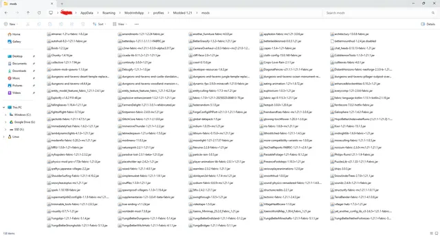

  5. ecruteakcity
    Image shared by ecruteakcity
