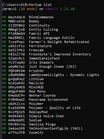

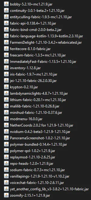

  3. fella_guy
    These are the other mods I'm using
    Image shared by fella_guy

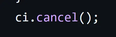

  31. kalucky0Team
    If they have a Discord server you can mention you can notify them there. I'll try to investigate why that mixin is doing that. After a quick look it seems like it ignores all non-minecraft bindings (?)

  38. kalucky0Team
    I rewrote the way key events are detected. Previously it was checking every tick if a bound key was pressed. Now I'm hooking into Minecraft key press event, retrieving a keybind based on that, and executing all commands, if it exists.
