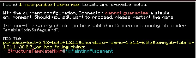

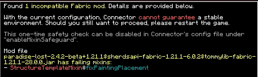

    Does paradise lost work with sintra connector? its giving me a warning
    Image shared by cooly1234
  5. cooly1234
    ok thanks
    nop wait thats fixed
  7. cooly1234
    which one?
    2.4.1-beta+1.21.1-SINYTRA should be the latest one for neoforge https://modrinth.com/mod/paradise-lost/version/2.4.1-beta+1.21.1-SINYTRA

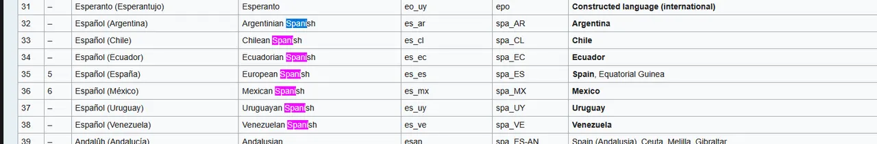

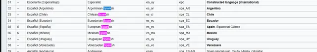

    @🗡️‹Kro Thells› one more question, which spanish should I put this under? all of them?
    Image shared by cr24
  11. 🗡️‹Kro Thells›
    Ehh...
    yeah I am naively going to assume that they are close enough that the mod would benefit from having all of the spanishes be populated even if they're slightly wrong it's better than no translations. surely its 99% the same
  13. 🗡️‹Kro Thells›
    It all boils down to things like "piedra" or "roca", which are very similar works, so, it shouldnt really matter(edited)
