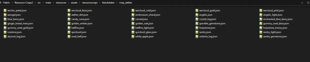

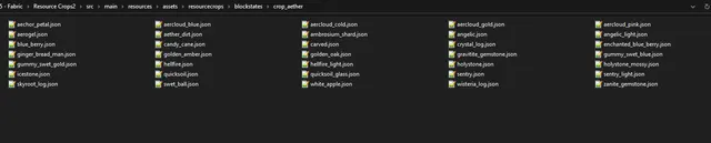

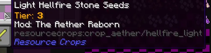

- MAlso something I thought was worth mentioning in here is that I found out that you can use a / in the identifier I believe it's called. An example of how I make use of that in my Resource Crops Mod is this: crop_ae2/certus crop_aether/ambrosium_shard What this allows you to do is sort the blockstates and model/item/ folders. So with the examples I showed above it's now looking for these files: blockstates/crop_ae2/certus.json models/item/crop_ae2/certus.json blockstates/crop_aether/ambrosium_shard.json models/item/crop_aether/ambrosium_shard.json The only thing worth mentioning is that in the language file you need to use a
.instead of a/. The reason I'm mentioning this here in this server is because of the ludicrous amount of blocks that the Aether has, I'd imagine the blockstates folder starts to look a bit messy as you add more and more blocks. For the Aether you could do something like this: mossy_holystone/mossy_holystone mossy_holystone/mossy_holystone_stairs mossy_holystone/mossy_holystone_wall mossy_holystone/mossy_holystone_slab(edited)16:36bricks/holystone bricks/angelic bricks/hellfire etc.(edited)16:37For the end user it makes no difference at all, but it should make working with the files a lot easier16:38Alternatively you could just use a JSON Serializer so that you don't have to bother with JSONs at all if you know how to make that (unlike me who doesn't know how) - H17:10I use /'s in my IDs sometimes, but I didn't realize they resolved it properly for those things.

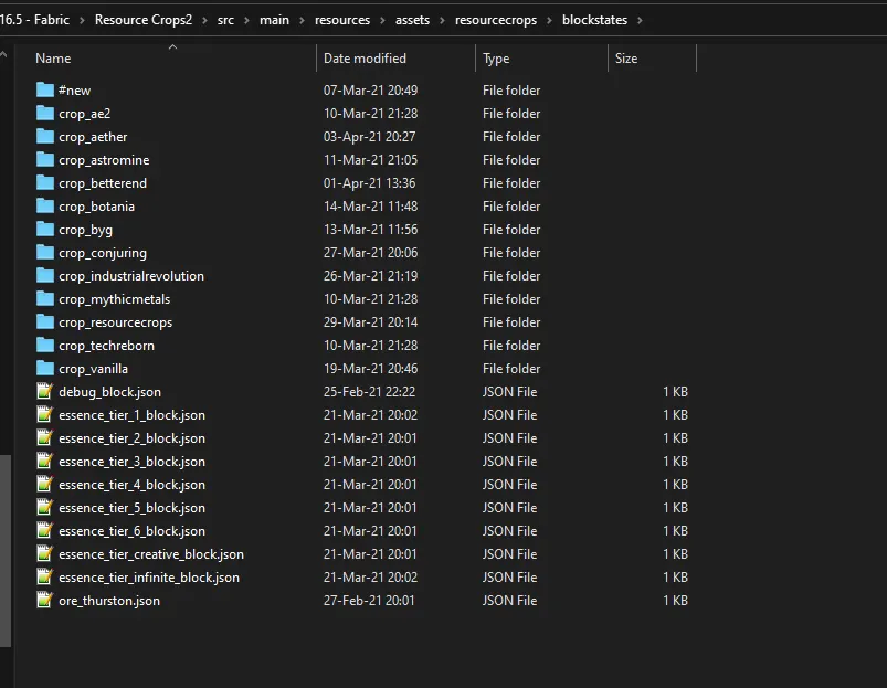

Replying toHaven KingWait, that works for model and BlockState folders?!
yeah it does, the block model path is defined in the blockstate json so you can always sort the block model folder, but using the method I just described you can use subdirectories in the blockstate and item model folder as well - M
Here's what the root of my blockstates folder looks like
18:53with everything related to <something> in 1 folder, in this case everything that's related to the aether
