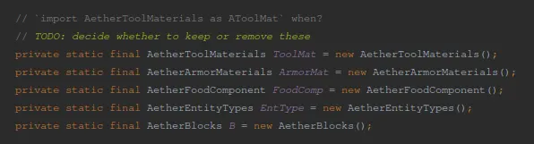

    @Azzyypaaras Thoughts on this?

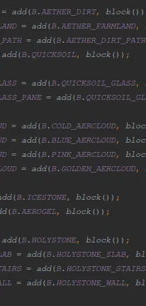

    Image shared by Solly
    @Solly that is... wack, yet surprisingly sleek
  4. SollyTeam
    @Haven King
  5. Haven King
    What is block :concern:
  6. SollyTeam
    block is a method that creates an item Settings for the aether blocks category
  7. Haven King
    If they're all the same, why not just have a single static instance?
  8. SollyTeam
    I probably will before I'm done(edited)

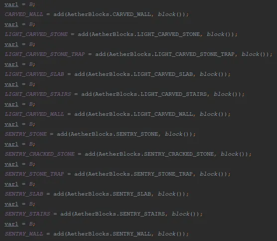

  9. Haven King
    AetherBlocks should not be able to be instantiated.
  10. SollyTeam
    The block registry was constantly changing it, so I replaced it with it with a method call there, and it carried over to the items(edited)
  11. Haven King
    Especially as those are static fields, you should just reference them with AetherBlocks.HOLYSTONE_WALL etc.
  12. SollyTeam
    Yeah, the reason for the instantiation was to shorten the lines to improve readability. Yes, it's messy
  13. Haven King
    You can just do a static import then.
  14. SollyTeam
    No, because the block names are the same as the items
  15. Haven King
    Though that's not really best practice either, as then the items and fields have to have different names.
  16. SollyTeam
  17. Haven King
    I don't see the issue with doing AetherBlocks.WHATEVER.asItem()
  18. SollyTeam
    Well, not often right now, because it was always asItem, but we will
  19. Haven King
    It's only marginally longer than AetherItems.WHATEVER and reduces codebase complexity significantly.
    Replying toHaven KingI don't see the issue with doing AetherBlocks.WHATEVER.asItem()
    There is a massive issue don't you see, it takes half a second longer to type :tater:
    • 🙃1
  21. SollyTeam
    How?
    :huh:
  23. Haven King
    Because then you can have just one method in AetherBlocks that's called for each block that needs an item.
    static <T extends Block> T register(Identifier id, T block) {
      T registered = Registry.register(Registry.BLOCK, id, block);
      Registry.register(Registry.ITEM, id, new BlockItem(registered, ITEM_SETTINGS);
      return registered
    (edited)
  24. AzzyypaarasTeam
    Do not question why blueberries are BlockItems
  25. Haven King
    I don't think any of those are major benefits. For the few block items that do look out of place in the midst of other blocks (such as blueberries), those few could simply be registered in the items class.
  26. SollyTeam

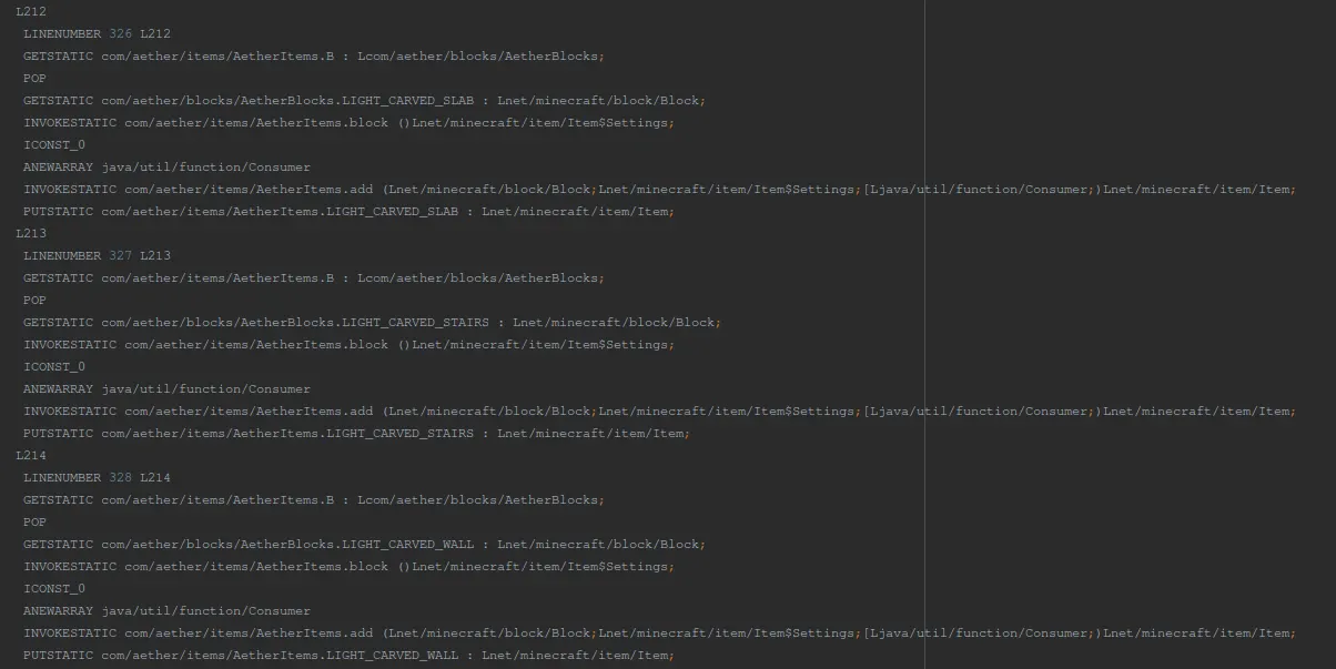

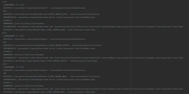

    It looks like it does still get B, then immediately yeet it
