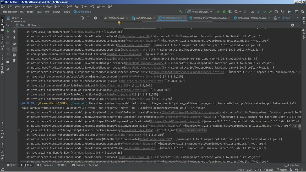

    java.lang.RuntimeException: Could not execute entrypoint stage 'client' due to errors, provided by 'the_aether'!

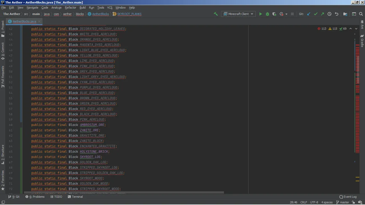

    @Azzyypaaras I added shitton of blocks You might want to check them out
    oh boy

    @Azzyypaaras https://hastebin.com/ipidokocid.log You need to see this crash
    Recursion got ya ass :tater:

  11. Deleted User
    There are currently more lines of errors that there are lines of code

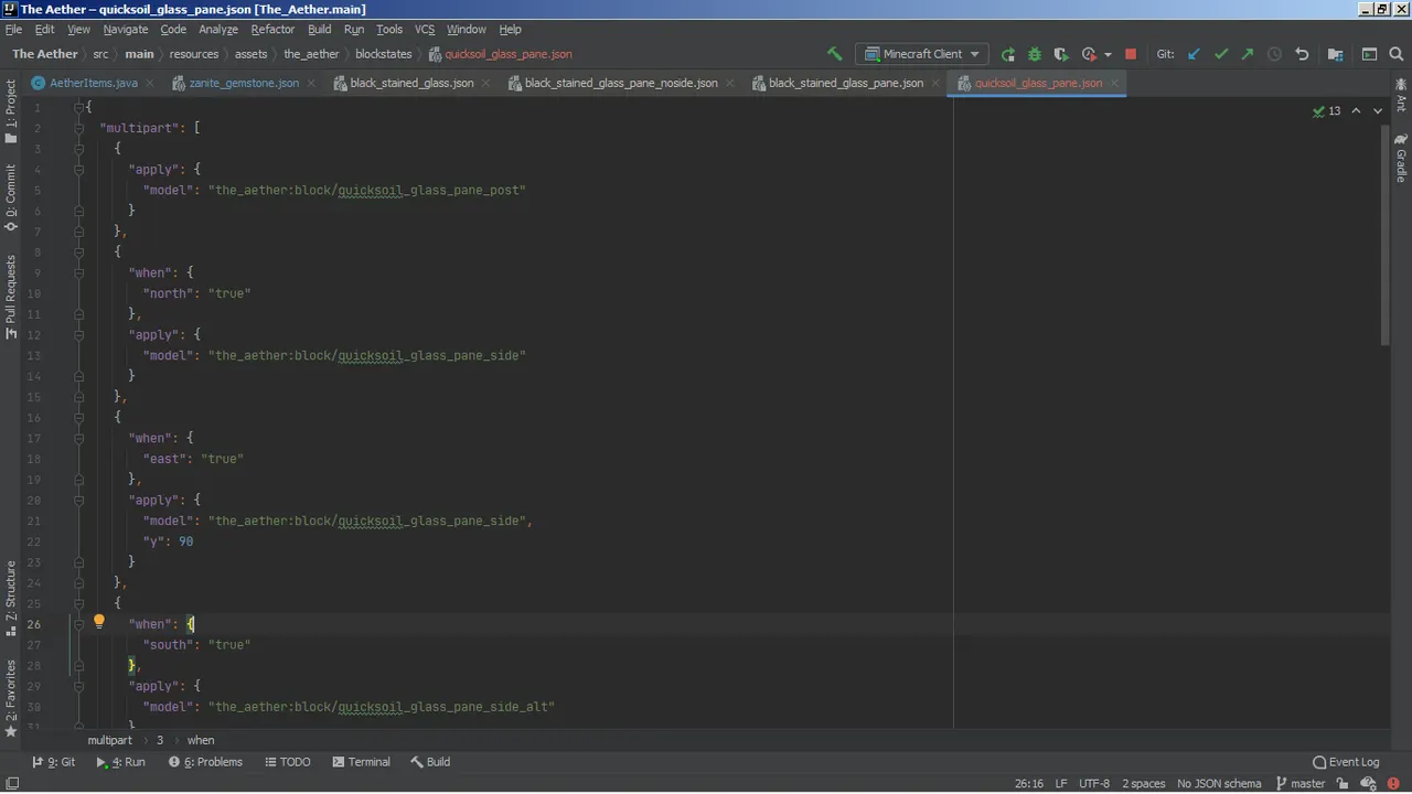

  27. Deleted User
    Any ideas about this

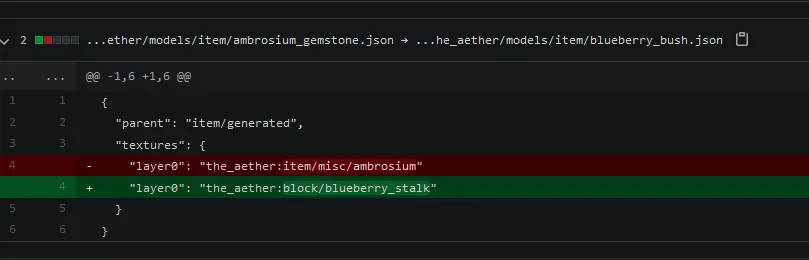

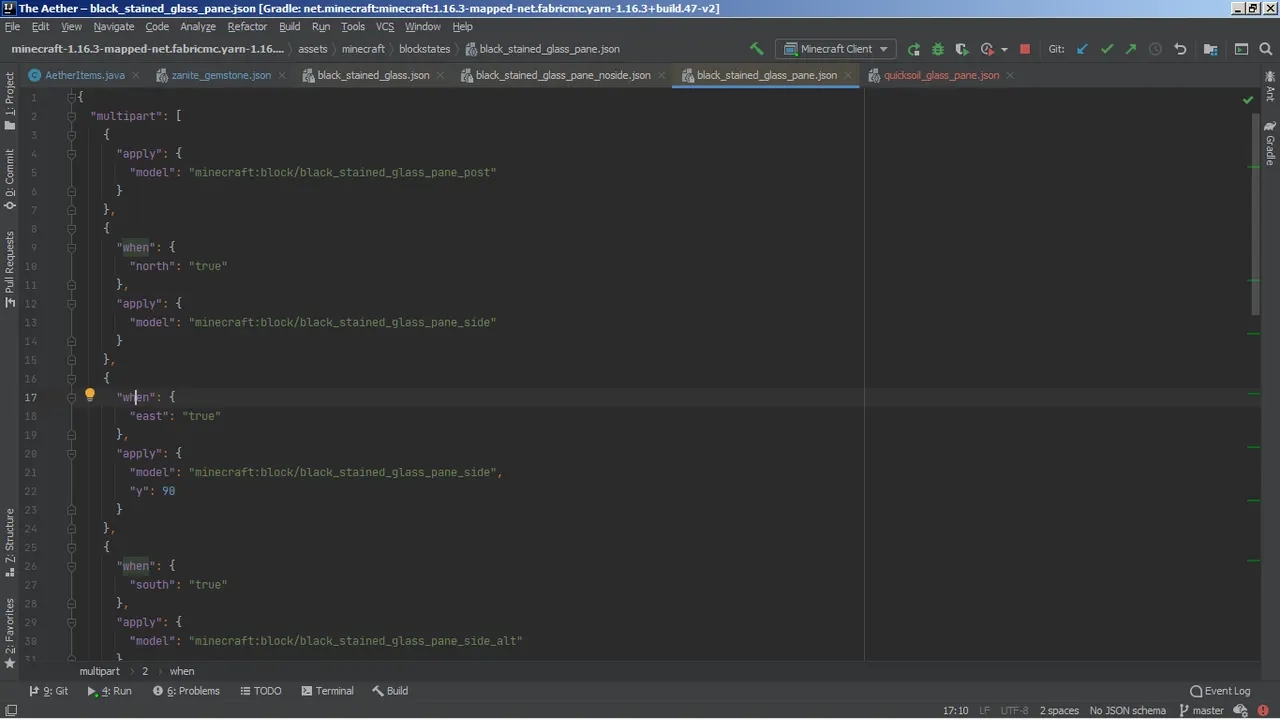

    Exception evaluating model definition: 'the_aether:quicksoil_glass_pane#'
     java.lang.RuntimeException: Unknown property 'north' on 'Block{the_aether:quicksoil_glass_pane}'
  28. CDAGamingTeam
    In all the maintainers that were put into the archive project, not one of them wanted to touch the models ironically xD Bet it's something simple, check mc's glass pane @Deleted User
  29. AzzyypaarasTeam

  32. Deleted User
    It's freaking same
  33. AzzyypaarasTeam
    We require concern and yeefuckinhaw

  35. AzzyypaarasTeam
    Kal, did you append the properties to the block?
  36. Deleted User
    uhm, i think
  37. AzzyypaarasTeam
    kal
  38. Deleted User
    I'm lost
  39. AzzyypaarasTeam
    @Override
        protected void appendProperties(StateManager.Builder<Block, BlockState> builder) {
            builder.add(RIPE);
            super.appendProperties(builder);

    bruh
  43. Deleted User
    Ok, all works

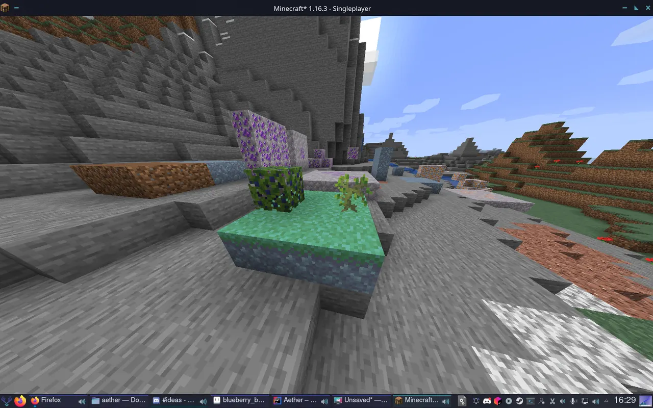

    Blueberries fully implemented, I'll push soon
    @Azzyypaaras define soon
  65. AzzyypaarasTeam
    Got dragged away for lunch :p
  66. Deleted User
    They look like alien insects
