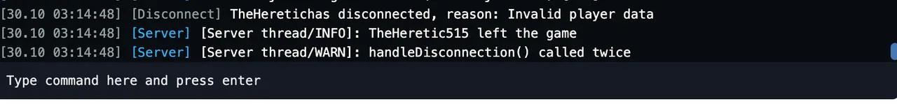

  7. hesitantalien77
    This is what it says in the console
    Image shared by hesitantalien77

  9. NoaaanTeam
    Not being able to log in throws the dumbest error. Some mods Discord linking/integration is failing and is throwing you out

  15. hesitantalien77
    Alright deleted it, testing it out right now
  16. hesitantalien77
    So far so good!
