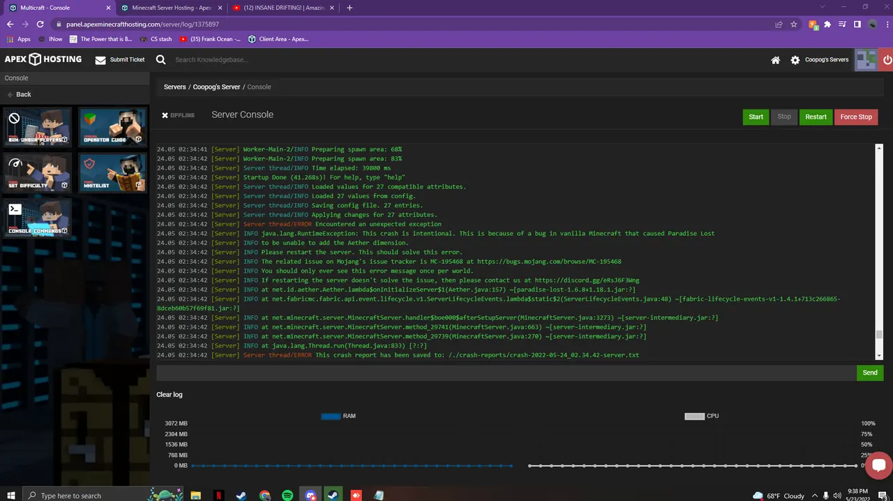

    This crash is intentional. This is because of a bug in vanilla Minecraft that caused Paradise Lost to be unable to add the Aether dimension.
    Did restarting the server work
  3. wilburt
    ive reset multiple times and it doesnt fix
    What version are you on

    Ok
  7. wilburt
    we're using a mod pack called origins adventure
    Ah, you need to update the mod
  9. wilburt
    how exactly do i do that
  10. wilburt
    ok trying that now
    That won't actually fix the cause of the crash but it should let you bypass it

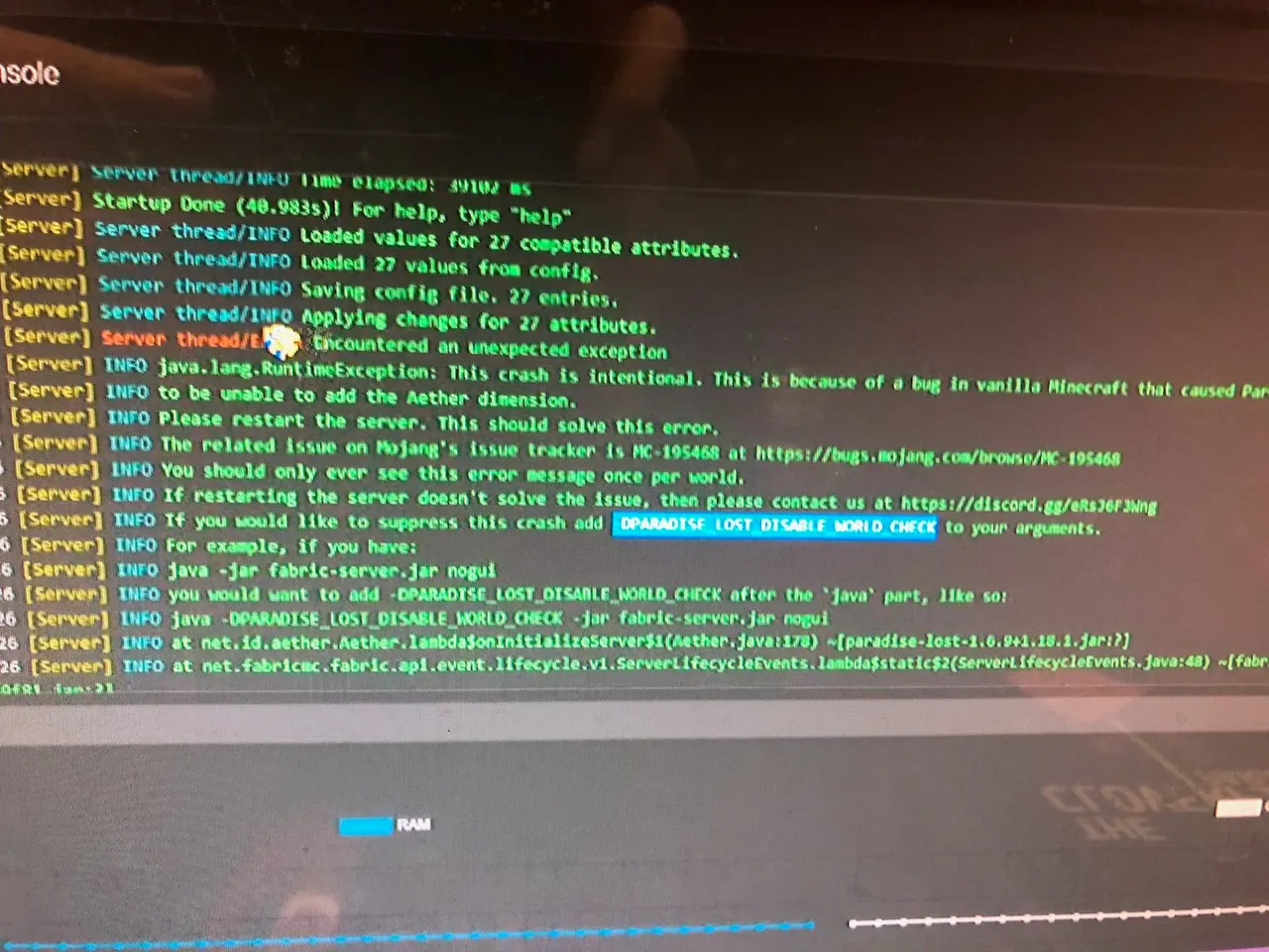

    do you have any idea where we’d find the “server arguments file” on that website, i know that’s not your specific field but we can’t find it
  17. Jack PapelTeam
    It might be a text input field that says "JVM arguments", or something
  18. wilburt
    it gave us this and we can’t find where to add that
    Image shared by wilburt
  19. Jack PapelTeam
    Your host might not have an option to add command line arguments
  20. wilburt
    yikes
  21. Jack PapelTeam
    I recommend updating to 1.18.2, where our mod doesn't have this issue, or wait for an update from us that fixes it
