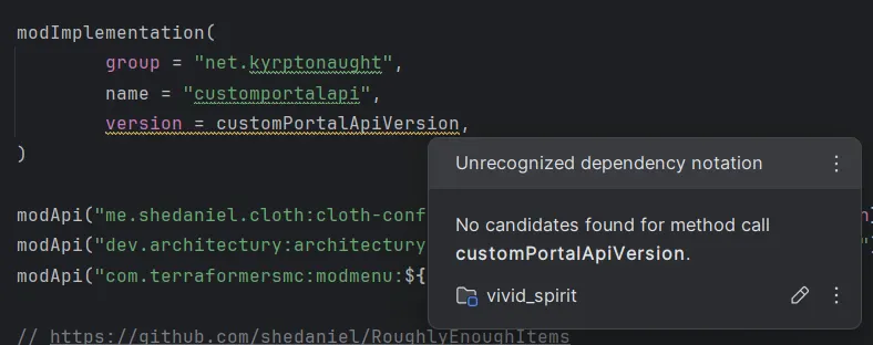

  6. Bee
    thank you. the only problem is that the apiversion part gives an error ^^'
    Image shared by Bee
  7. cr24Team
    ah we pull that from a different file where the versions are stored, do you have a file like that where you specify versions for modmenu and stuff (i see in your screenshot)
  8. Bee
    oh! right. the gradle.properties ^^'
    yep!
    • 💛1
  10. Bee
    thank you so much, i'd just totally forgotten about the properties editing!!
