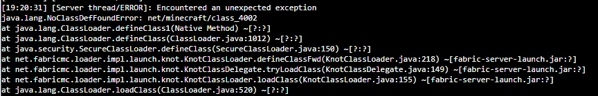

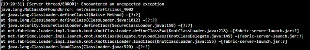

    Well the leaves seem to be working fine rn
  99. gudenau
    Oh.
  100. kitrod
    blur works
  101. gudenau
    Specifically SpriteProvider is trying to load here.
  102. Jerakl
    crash long in #unknown
  103. kitrod
    sodium still doesn't work
  104. cr24Team
    and i oop\
  105. Jack PapelTeam
    Well hm
  106. cr24Team
    methinks something client side is happening server side
  107. Jack PapelTeam
    It looks like it has to do with the particles according to the crash report
  108. cr24Team
    ye
  109. Jack PapelTeam
    at net.id.aether.client.rendering.particle.AetherParticles.<clinit>(AetherParticles.java:12)
  110. gudenau
    I think I see what is happening here.

    spawnPetalBurst() was used in randomTick instead of randomDisplayTick
    • :concern:1
  116. gudenau
    It is also used in onUse.
  117. Jack PapelTeam
    Ah, so that'd do it

  158. KyrptonaughtTeam
    Ah nice thats mc gobbling up an exception loading the player and outputting a nice useless message
  159. Larry Cable Guy
    [00:24:21] [Server thread/INFO]: com.mojang.authlib.GameProfile@38162a33[id=a250dea2-a0ec-4aa4-bfa9-858a44466241,name=pietoday01,properties={},legacy=false] (local:E:6c060f46) lost connection: Invalid player data [00:24:21] [Server thread/WARN]: handleDisconnection() called twice It gave that in the log, if it helps

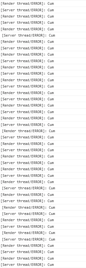

  163. Xanthian
    is there a particular reason why my log file is spammed with 'cum' when I go through the portal? is this a bug or some attempt at a puerile joke
  164. KyrptonaughtTeam
    That’s definitely a feature
  165. Xanthian
    it doesnt stop until i exit the aether
  166. KyrptonaughtTeam
    I found it, it’s to do with the rook
  167. Xanthian
  168. KyrptonaughtTeam
    Glad you’re enjoying it! Picked a good time to try it out with all the new goodies released in 1.6

    Replying toXanthianan attachment
    oh goddammit
  173. Xanthian
  174. AzzyypaarasTeam
    I was using that to test something and forgot to take it out for the final release
  175. Xanthian
    Intrigued as to what exactly you were testing with that 😂
  176. AzzyypaarasTeam
    Replying toXanthianIntrigued as to what exactly you were testing with that 😂
    this singular piece of code since I always forget how you check what dimension a player is in

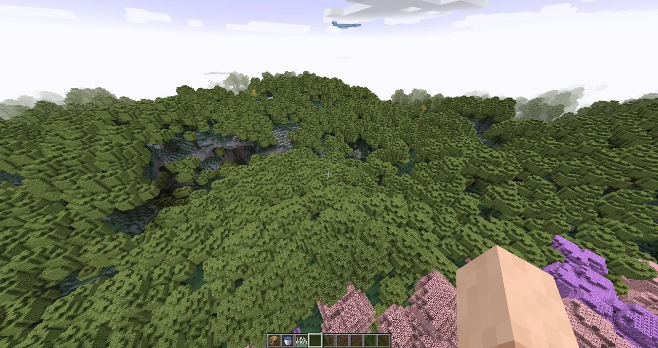

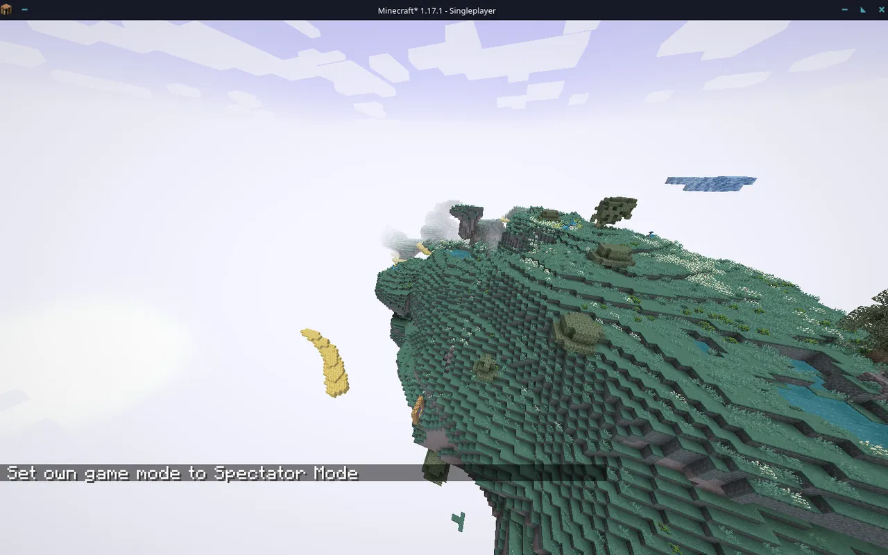

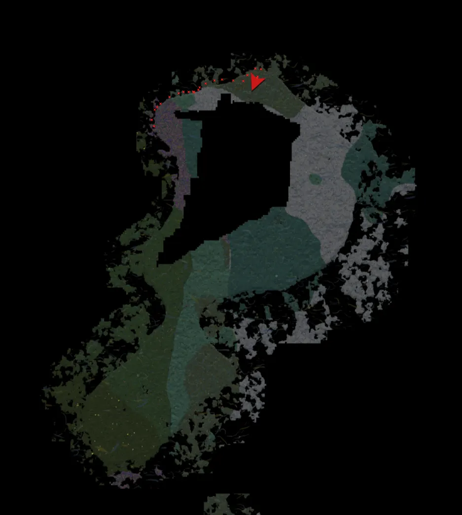

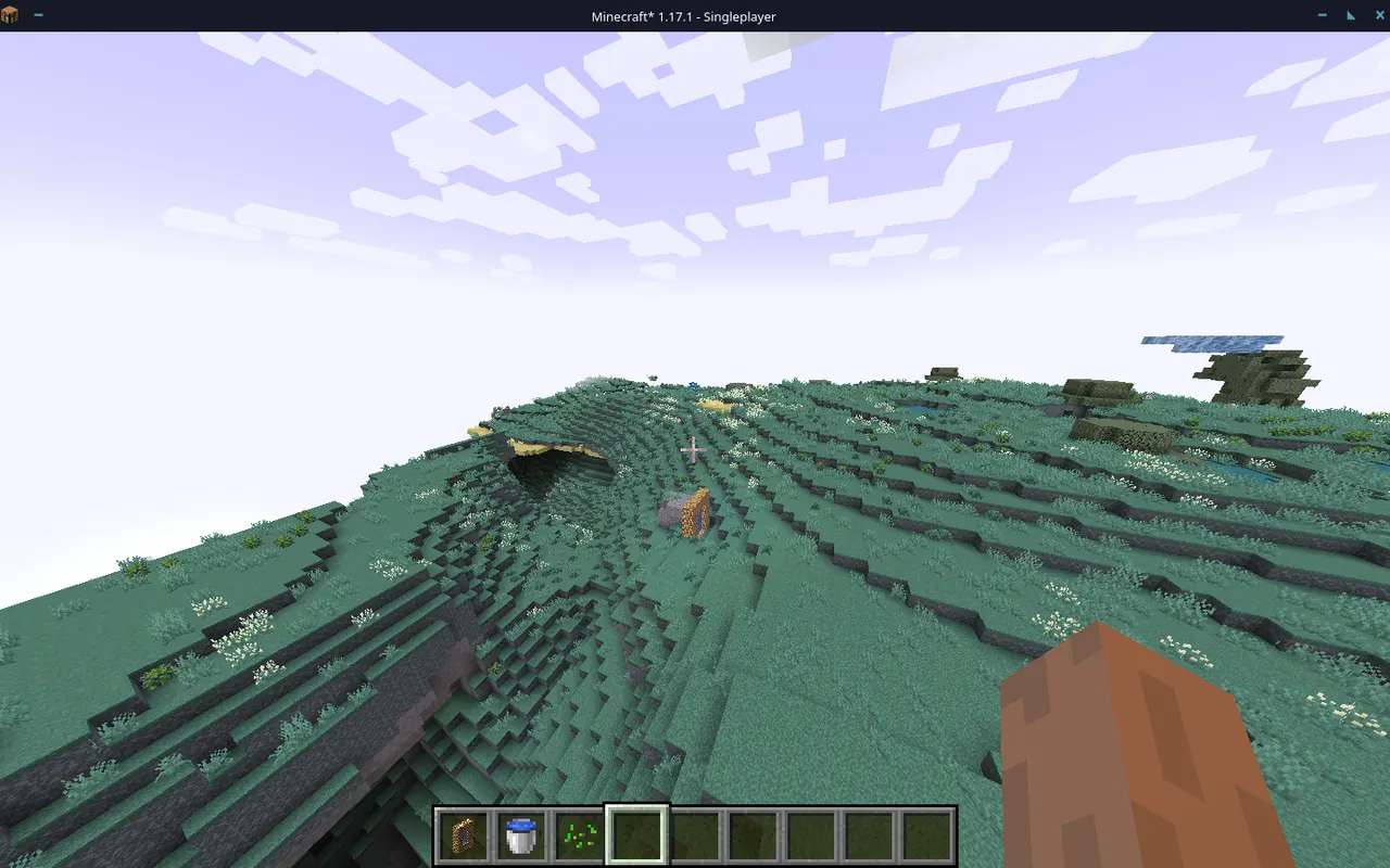

  180. Katie
    is this terrain gen intentional? this island doesnt have edges for some 1000 blocks lol
    Image shared by KatieImage shared by Katie
  181. Jack PapelTeam
    Hm, that doesn't look right
  182. Katie
    just performance mods
  183. Jack PapelTeam
    Hm, I haven't seen this issue myself, but I remember someone with a similar issue a while ago
  184. CDAGamingTeam
    Replying toKatieis this terrain gen intentional? this island doesnt have edges for some 1000 blocks lol
    I'll be honest, I have never seen it generate like that

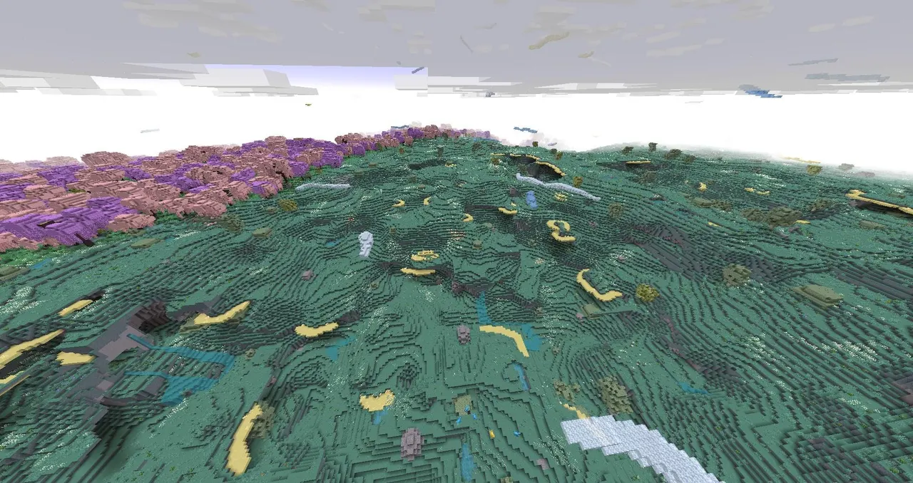

  185. Katie
    player on our server mapped out the perimeter of their one

  189. Katie

  191. Jack PapelTeam
    Replying toKatielol
    That's really strange. This was fixed ages ago

  193. Jack PapelTeam
    Are you on the latest release by the way? The water isn't fading
  194. CDAGamingTeam
    O.o
  195. AzzyypaarasTeam
    Well, there is a continental plateau biome there, so i would say yes
  196. CDAGamingTeam
    It could be a dev build of 1.6.0
  197. Jack PapelTeam
    The water might just be the performance mods doing that
  198. AzzyypaarasTeam
    Fading water was in long before the new biomes
  199. CDAGamingTeam
    Ah true
  200. AzzyypaarasTeam
    Replying toJack PapelThe water might just be the performance mods doing that
    Most likely thing, I imagine something like sodium would not enjoy what hackery I did to get htat to work

  216. Katie
    generates the same without any other mods
  217. AzzyypaarasTeam
    Given that this is not the first time this worldgen quirk rears its head, I have the feeling it is going ot haunt us for a while
  218. Jack PapelTeam
    Can you send the seed?
  219. Katie
    yeah one sec
  220. AzzyypaarasTeam
    I do have a theory as to why this is happening
  221. Katie
    1669816108867524909
  222. AzzyypaarasTeam
    Oz
  223. Katie
  224. AzzyypaarasTeam
    hm
  225. Katie
    can confirm the water fading was an iris conflict
  226. AzzyypaarasTeam
    'ight... yeah I can tell right away that this is it
  227. Katie
  228. AzzyypaarasTeam

  231. luka
    So i logged off in the aether, and whenever i try to log back in i instantly get kicked and crash. This is my crash report:
    message.txtText file, 9 KB. Not stored in the archive.
  232. AzzyypaarasTeam
    I see a cannot invoke
  233. luka
