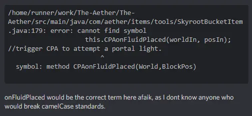

    @Kyrptonaught Can you check this function, as while before it was only effecting a PR, it's now effecting the main branch as well now...

  2. KyrptonaughtTeam
    Replying toCDAGaming@Kyrptonaught Can you check this function, as while before it was only effecting a PR…
    So this is only happening on the CL builds, but not in dev env?(edited)
  3. CDAGamingTeam
    Seemingly afaik
  4. KyrptonaughtTeam
    Just tested, no issues in dev env
  5. CDAGamingTeam
    Ah, then somehow it's failing in just the CI for some reason 🤔
  6. KyrptonaughtTeam
    I have no idea what that could be caused by. Would anyone be against me making the skyroot bucket extend normal bucket? I’ll retain functionality. This would eliminate the need for that call. Kinda a round about way to fix it lol
  7. CDAGamingTeam
    Sure, send in a PR and I'll merge it if all goes ok 😄
  8. KyrptonaughtTeam
    Mojank angers me, buckets are very hard coded. Trying to do it without any mixins
  9. KyrptonaughtTeam
    That would be the proper solution yeah. Still have no idea how to fix this build issue though
  10. KyrptonaughtTeam
    Replying to a message that isn't in the archive
    It seems like the skyroot bucket purposely doesn’t support every fluid. Mainly not supporting lava, since it’s made out wood.
