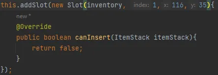

    I've created a custom block and block entity in fabric, but I can't figure out how to prevent items from being put in the output slot by the player. Does anyone have an idea on how to achieve this?

  5. NoaaanTeam
    Extend the slot and override canInsert I think

    Replying toNoaaanExtend the slot and override canInsert I think
    Thanks a lot, this worked
    Image shared by Mopsy
