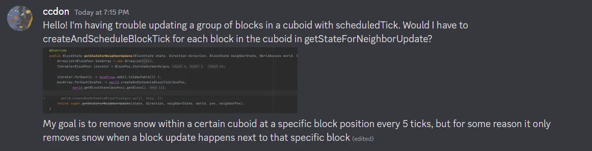

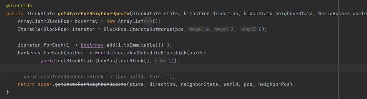

    Replying tocymbidialHere's the beef! I'm not sure if what I'm doing with these iterators are entirely safe.
    Sponge does a similar thing with water. I'd recommend taking a look at how they do it

    Replying toJack PapelSponge does a similar thing with water. I'd recommend taking a look at how they do it
    hoho, I just banged my head against the source code for a good two hours. Is there a way to define the area where neighborUpdate is called?

  18. cymbidial
    nvm! just found out what was happening! i forgot to append the ticksRandomly() block setting to the block! i totally didn't waste 10 hours of my life!
