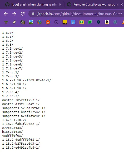

    thank you, but new issue: https://maven.jamieswhiteshirt.com/libs-release/com/github/devs-immortal/Incubus-Core/1.6.x-SNAPSHOT/Incubus-Core-1.6.x-SNAPSHOT.pom throws this error: "message" : "The repository 'libs-release' rejected the resolution of an artifact 'libs-release:com/github/devs-immortal/Incubus-Core/1.6.x-SNAPSHOT/Incubus-Core-1.6.x-SNAPSHOT.pom' due to conflict in the snapshot release handling policy."

  9. thea
    odd, 1.6.6 is actually listed there but doesn't seem to exist
    Image shared by thea
    huh?
    The current PL uses 1.6.x-1.18.2 branch
  12. thea
    1.18.2-SNAPSHOT does work, thank you if you put 1.7 on the maven I'd be happy to clean some buildscript stuff up for you and do the update
