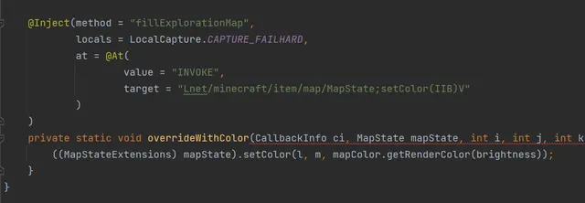

- J03:26Do you know what's up with my mixin though?

- J03:29

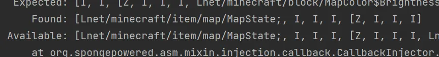

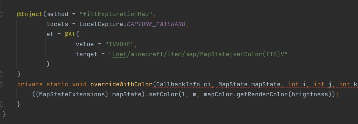

@Inject(method = "fillExplorationMap", locals = LocalCapture.CAPTURE_FAILHARD, at = @At( value = "INVOKE", target = "Lnet/minecraft/item/map/MapState;setColor(IIB)V" ) ) private static void overrideWithColor(ServerWorld world, ItemStack map, CallbackInfo ci, MapState mapState, int i, boolean[] bls, int l, int m, int category, MapColor.Brightness brightness, MapColor mapColor, MapState mapState, int i, boolean[] bls, int l, int m, int category, MapColor.Brightness brightness, MapColor mapColor, MapState mapState, int i, boolean[] bls, int l, int m, int category, MapColor.Brightness brightness, MapColor mapColor, MapState mapState, int i, int j, int k, boolean[] bls, int l, int m, int category, MapColor.Brightness brightness, MapColor mapColor) { ((MapStateExtensions) mapState).setColor(l, m, mapColor.getRenderColor(brightness)); }03:29Here's after the plugin "fixing" it - G03:29It grabs all the locals it can then.
- J03:29It grabs more than that exist

Replying togudenauLooks like it wants int, boolean[], int, int, int, etc..
This is what my parameters look like03:33But mixin says otherwise - G03:33Did you print it before?

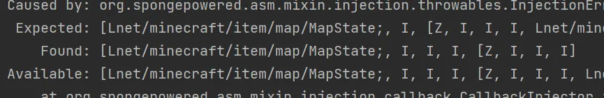

Replying togudenaufound is what you wrote, expected is what it can access, available I don't know.
it got the found section wrong btw. I wroteprivate static void overrideWithColor(ServerWorld world, ItemStack map, CallbackInfo ci, MapState mapState, int i, boolean[] bls, int l, int m, int category, MapColor.Brightness brightness, MapColor mapColor) { ((MapStateExtensions) mapState).setColor(l, m, mapColor.getRenderColor(brightness)); } - G

Replying togudenauI don't know.
I read this in the voice of the little guy from kung fu panda03:36I don't remember his name03:36Master something(edited) - G03:36Or whatever.

- J04:19Maybe04:19It's super ass backwards though04:20So I think it reads what you have, and then tries to figure out if that's correct. So expected is what you have, and it expects the original method to have that. Found is what the original method offers, and available is something else I guess04:21So it's like from the perspective of the mixin. Seems super counterintuitive(edited)04:22Got map packets working

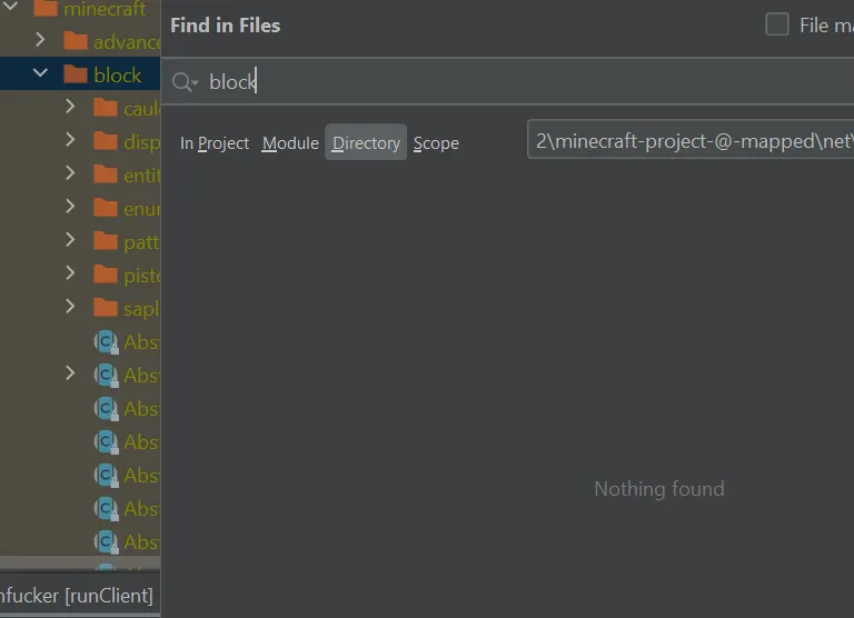

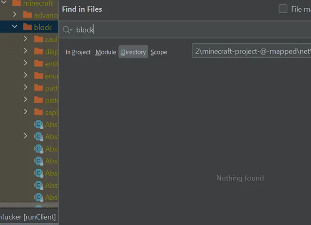

- J04:30The map code is spread across
\render,\item,\block,\network, you name it04:30Chances are, if you can think of a directory, there's map code there04:32Oh wait hold on I can just unzip it04:33Nevermind, IntelliJ is stupid04:34mp4Map-Unfucker_MapState.class_Gradle__net.minecraft_minecraft-project--mapped_1.18.1_net.fabricmc.yarn.1_18_1.1.18.1build.1-v2_2022-01-11_20-34-28.mp4Video, 6.8 MB. Not stored in the archive.04:35Can't find a block in the blocks folder04:35Oh the popup isn't recorded04:36(The project name is temporary) - G
