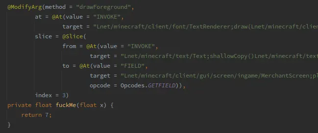

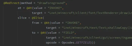

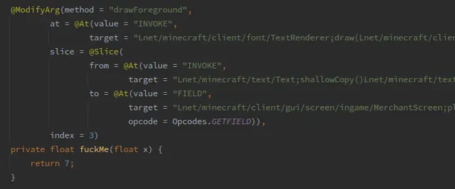

    Changing a 6 to a 7 be like
    Image shared by Solly
    I'd like to think that the method is just return 7;
  3. SollyTeam
    Actually, I can do that
    > says he can't do modifyarg > immediately responds with code featuring modifyarg
  5. SollyTeam
    Yeah I realised the issue doesn't exist anymore
    What was the issue?
  7. SollyTeam
    Slice being awkward to match
    tf are you two nerds up to
    Alright, idk much about slice so I'll take your word for it
  10. SollyTeam
    Needing to use another parameter to determine if it should be modified

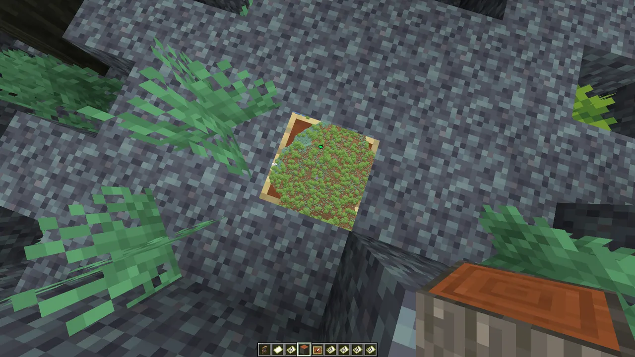

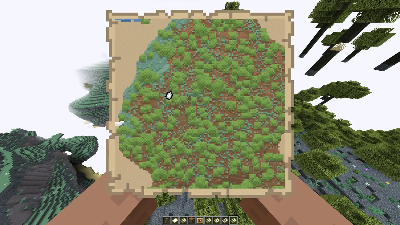

  22. SollyTeam
    @Azzyypaaras How's this, instead of the fixed blue background?
  23. Jack PapelTeam
    Hm I wonder why the background is checkered instead of empty
  24. SollyTeam
    Checkered is just how vanilla handles empty maps
  25. Jack PapelTeam
    Oh

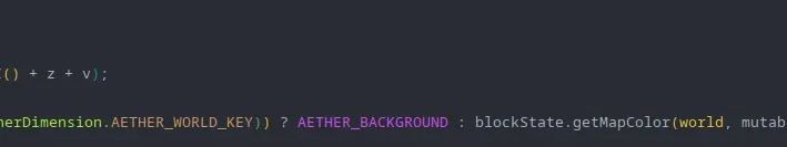

  33. SollyTeam
    Easiest solution then, just add the aether colour and use it for aerogel or something
  34. AzzyypaarasTeam
    hm
  35. SollyTeam
    At least don't waste it only on a background(edited)

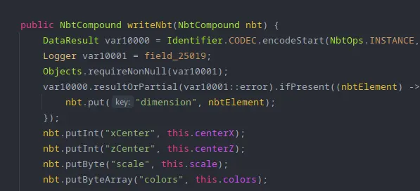

    Ahah, maps are saved directly to world
  45. Jack PapelTeam
    I would assume it puts a byte array
  46. AzzyypaarasTeam
    Ok so uhhhhh
  47. SollyTeam
    Just
  48. AzzyypaarasTeam
    It would require a bit of mixin, but there aren't any particular hard caps
