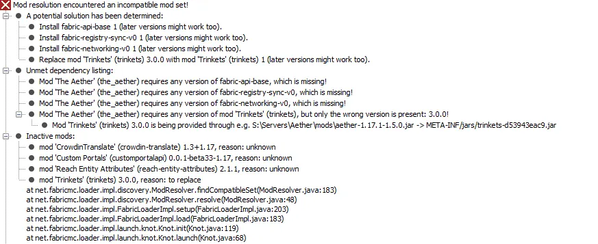

    hey uhh
    Image shared by SweetSpot
    What's the fabric API version?
  5. SweetSpot
    can someone point me in the right direction im not sure what im looking at
    What fabric API version are you using
  7. SweetSpot
    0.12.5
    ...that is not the fabric api
  9. SweetSpot
    this is for the server btw
    You need to install fabric API
  11. SweetSpot
    ohhh
  12. SweetSpot
    omfg
    We all make mistakes 😁
