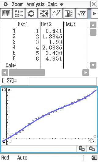

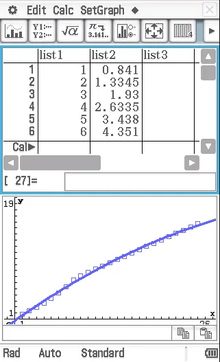

    But how does that translate to distance moved?
    When it jumps, it has a y velocity and a horizontal velocity (the first bit I sent). Then it just follows that trajectory. You could work out the landing position with a quadratic and calculate it that way

    That's what I've been trying to do
    I'll see what I get with my calculations
  15. SollyTeam
    A quadratic is close enough, but it has that weird bit of error
    Yeah my calculations don't match up either
