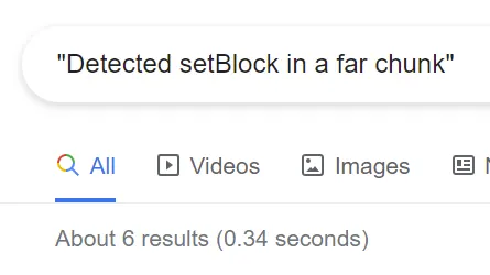

    that happens in vanilla with nether ruin portal
  3. LudoCrypt
    whats the error
    Replying toFrqnnyinside a ChunkRegion#setBlockState it checks if its setting inside the prescribed…
    Thanks for the help, I'll see what I can do with this information
  5. Frqnny
    the method it checks for is unnamed
    Seemingly there's not much I can do(edited)
  7. CDAGamingTeam
    Is there a way a sanity check could be added to ensure setBlock doesn't occur outside a certain distance
    Maybe
  9. CDAGamingTeam
    As the error itself is basically saying, setBlock was used at x,y,z, but the position we're currently generating at is a,b,c So logically, the best case is adding sanity checks to ensure setBlock is only executing where we want it too
    I added a check so that it wouldn't generate more than 10 blocks from the origin of generation, and the error still came up
    Ok

    Detected setBlock in a far chunk [15630, 15617], pos: class_2339{x=250080, y=39, z=249873}, status: minecraft:features, currently generating: ResourceKey[minecraft:worldgen/configured_feature / the_aether:rainbow_fallen_leaves]
