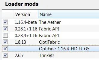

  3. XenialJesse
    Image shared by XenialJesse
  4. XenialJesse
    HavenKing provided a fix which I had been using. https://discord.com/channels/770691727568404521/770698788629118997/790375247307603968 That's why no-one else using the public beta is seeing any Optifine problem; the jar on modrinth doesn't have this Dawn API change. From what you guys were talking about back then, the crash with Opti might be related to this?:
    Caused by: org.spongepowered.asm.mixin.injection.throwables.InjectionError: Critical injection failure: Callback method dontChangeFogDensity(Lnet/minecraft/class_4184;Lnet/minecraft/class_758$class_4596;FZLorg/spongepowered/asm/mixin/injection/callback/CallbackInfo;)V in the_aether.mixins.json:client.BackgroundRendererMixin failed injection check
    (edited)
