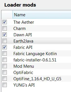

  17. XenialJesse
    I'm happy to give up Dawn for AR even in its alpha state, but to be fair on Dawn it was running with 6 other biomes mods

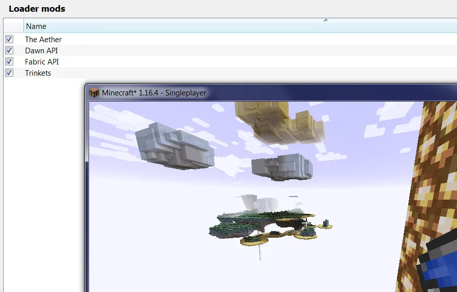

  19. Haven King
    Looks like you don't have the trinkets API installed
  20. XenialJesse
    ohhh
  21. Haven King
    Really we should have that listed as a proper dependency, so I'll throw that in there

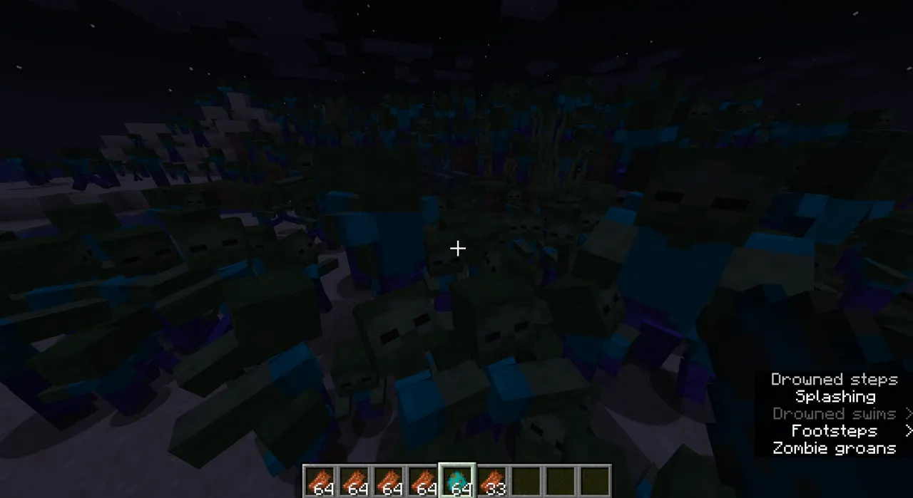

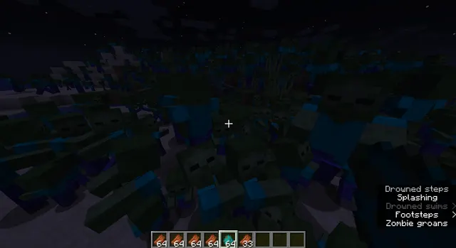

  28. XenialJesse
    I tried spamming zombie eggs just now and got the crash again after about 30 zombies. Also notable, that was the 2nd game I had to make to try. The first new game I made got the same crash within 5 seconds of starting.
  29. XenialJesse
    Checked with the v.1.0.0 jar (as I've been running the beta that Haven King linked me to earlier). Same result from the zombie eggs: eventual crash and can no longer reopen that world.
