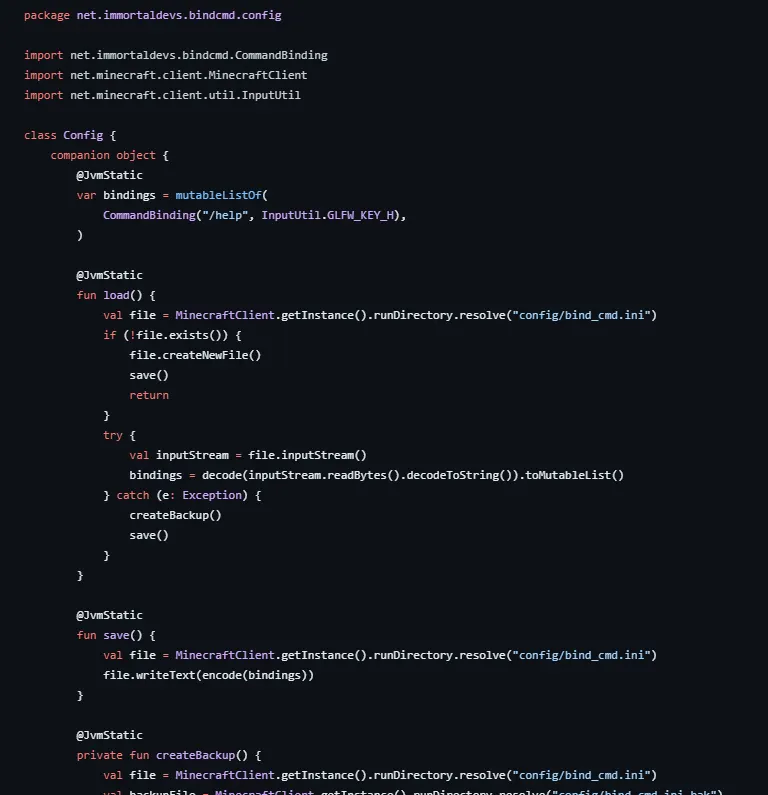

    hey, i was wondering if it would be possible to get the bindcommands mod with a few commands preinstalled like how the /help command is with h, without having to add them by going into the mods menu and adding the key binds. the reason i need it done like this is unimportant but the reason isnt that im having an issue adding the command the normal way i just want it to come preinstalled with a few commands. how would i edit the mod so that it could do that ?

    You can probably just copy the config file that is in the config folder in .minecraft

    I tried copying the whole mod after i set up all the commands and sent it to someone but sadly it didnt work

    Replying tokalucky0You can probably just copy the config file that is in the config folder in .minecraft
    i just wanna change this but when i download the source code and change it idk how to make it into a .jar file or how to make it work the way the actual mod does

  7. Cthul𝔥u
    i just got visual studio
  8. Cthul𝔥u
    i keep getting the error C:\Users\paini\OneDrive\Desktop\bind-cmd-master (1)>./gradlew build '.' is not recognized as an internal or external command, operable program or batch file.
  9. Cthul𝔥u
    Replying tokalucky0What IDE are you using?
    do i need to be on liinux ?
  10. Cthul𝔥u
    okay after installing gradle to my pc and running the command gradle build without any ./ its seems to have workd. it says that build was successful but i cant find a .jar file for the mod
