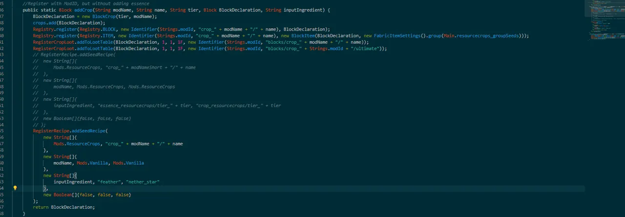

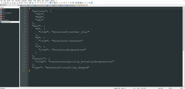

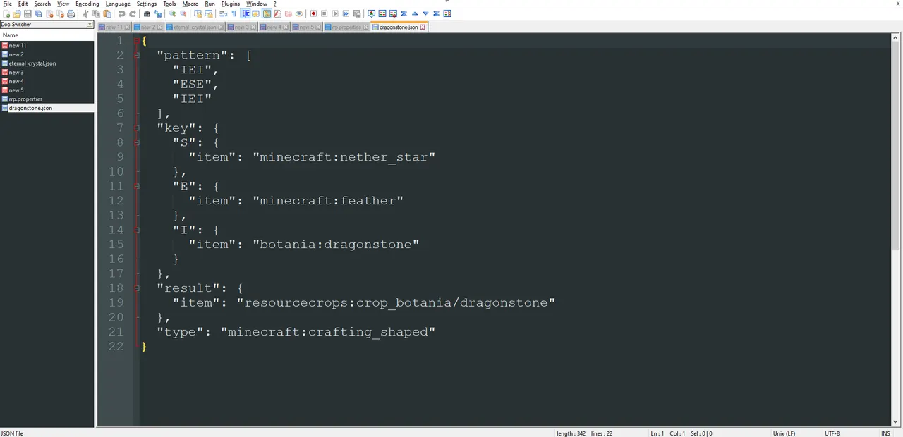

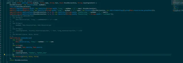

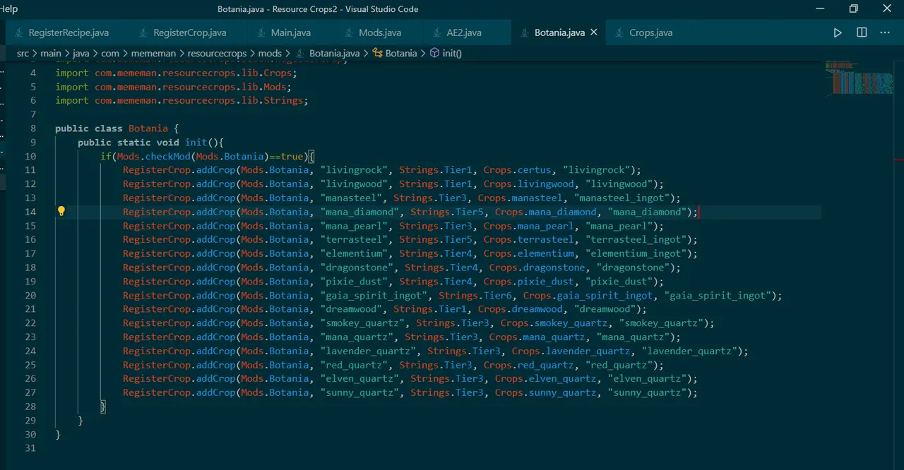

- M@Haven King finally got ARRP working for my automated recipe registry, these are the functions I made within my recipe registry, I only actually register things in this file whenever I need to do that manually.
19:59This is my Block registry which uses the same parameters for registering the Block to create a recipe for it

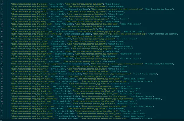

- M20:09I can just input the same name I use as the localized name, so "oak_log" I can split into an array containing ["oak", log"]; then combine them back into a string after capitalizing each item in the array and then add the word "Seeds" to it.(edited)20:09I don't even have to write the name itself lmao20:10this is the kinda thing that motivates me to code20:11managing to do something that seems difficult to me, and then after understanding why it wasn't working before but is working now, I can start to get creative with how I use it20:12the best way to learn is the fun way to learn(edited)

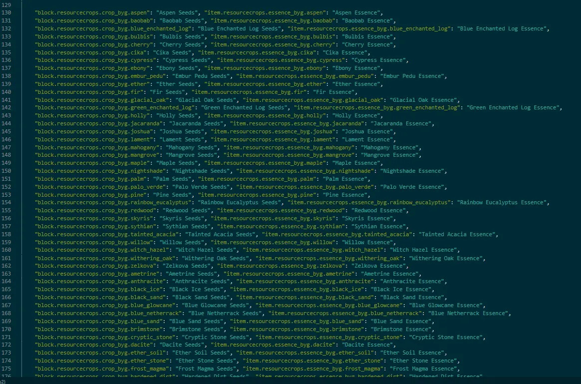

- H20:14Then your lang file would just be
And your item would do{ "magic_seeds.seeds": "%s Seeds" }@Override public Text getName() { return new TranslatableText("magic_seeds.seeds", this.resource_block.getName()); }20:14So the block names will be automagically translated20:14And you literally just have to translateSeeds - MThis looks really interesting, I did know that Mojang does stuff like this with Death Messages for example, but I didn't know how to do this myself20:16Never even thought about it20:16but there's one thing I don't get20:17where am I actually inputting the name that will be shown in-game instead of
%s? - H

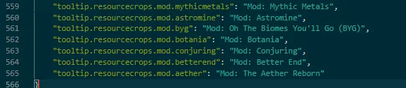

- MIf I put everything on a separate line like JSONs should be and remove all the empty lines I end up with 566 lines or 564 if you don't count the
{and}at the beginning and end of the file
20:24and that is only going to increase more and more20:26btw @Haven King what does thesin%srefer to? You're not actually telling that getName funtion that%sis what needs to be replaced with something. So why the lettersout of all things. Asking this because I know there's other letters I can do things with but I don't know the logic behind them - H20:27I'm actually not sure to what degree Minecraft verifies types

- M20:30Just know that if this works thanks to these few lines of code you told me, you'll have saved me HUNDREDS of lines in the language file

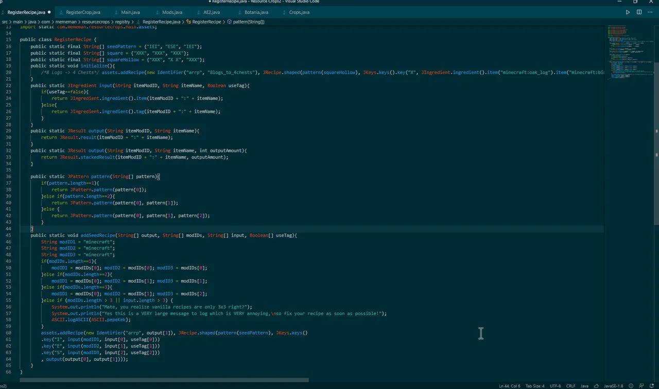

Also no hold on mine isn't even that, mine is literally just a block - H21:19Can you show your registration code?
- M
- HItems have to be registered independently from blocks. You can't just give somebody a block and call it an item.21:22So somewhere you have to make an item out of it, which can be pretty simple.
- Myeah I mean true but every block also needs an item registered for it. Of course I also have that. But there's none of that AliasedBlockItem Shenanigans connecting a fully separate seed to the crop block21:24I'm happy the way it works atm, but the basic registration function does need to be re-written sooner or later21:25. A problem with the way I'm doing it right now is that if you use REI + RoughlyEnoughResources, it doesn't actually show the item <X> drops from. it writes the crop name below it but it doesn't show an item which it normally does .(edited)21:26PROBABLY because I'm doing it slightly weird21:27I already know a lot more right now but keep in mind that this mod is legitimately the first fabric mod I've ever written .(edited)21:27So whilst I try to make it user-friendly and as clean as possible, it's still very much my own personal playground to toy around with

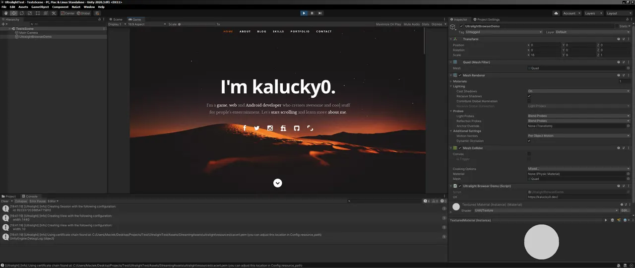

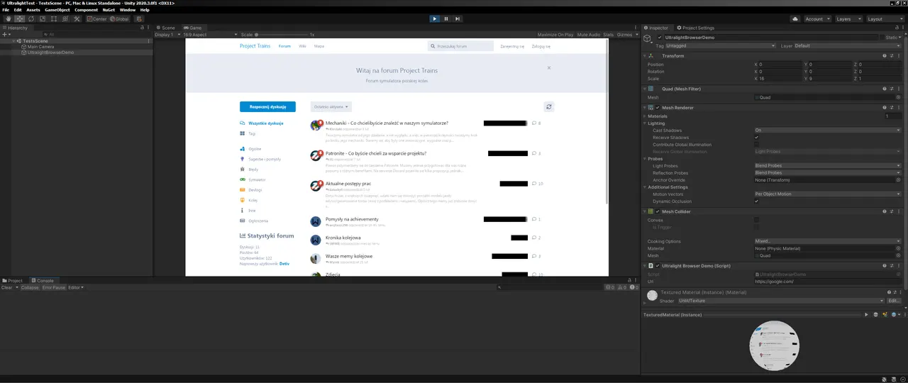

Replying tokalucky0I managed to implement a browser in Unity
kalucky0/UltralightUnityDemoDemo implementation of the Ultralight browser in Unity - kalucky0/UltralightUnityDemo
